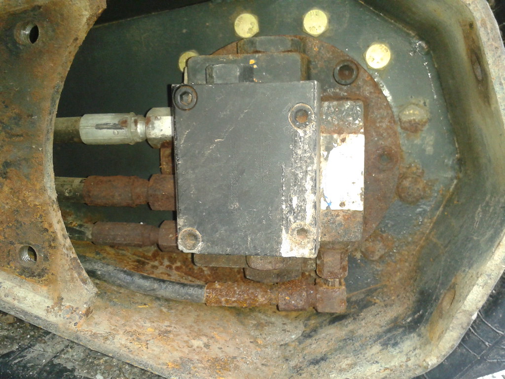

<blockquote data-quote="jmatt20" data-source="post: 67737" data-attributes="member: 186"><p>i believe someone had a post about this problem earlier..his blocks had deteriorated to the point he needed to replace them ,as i recall they were quite expensive . after his post i removed my covers to have a look see,,packed full of dirt . i pressure washed them and noticed the same sort of corrosion you have on the bottom left corner of your blocks ..the damn things look like they are made out of the same stuff as sacrificial zincs you put on boats !!!! they are aluminum but even in the southwest without salt being used on our roads they corrode like mad ..i take my covers off very often now,wash out and clean,re-coat with spray paint ..</p></blockquote><p></p>
