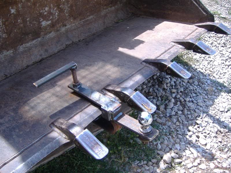

<blockquote data-quote="schneidp20" data-source="post: 70960" data-attributes="member: 10158"><p>I like this simple design, and the ball looks to be far enough in front so you can see it. I punched a hole in my bucket just behind the cutting blade to accept a ball. I hate it and will be building something like in this thread. Problems with mine are 1) can't seen the ball from a seated position. 2) if the bucket is tilted too far back, the cutter bar hits the tongue and pops the hitch off the ball. Dave 553</p></blockquote><p></p>
