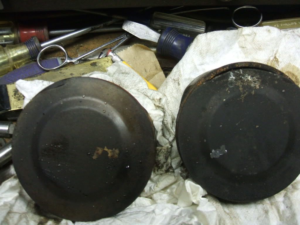

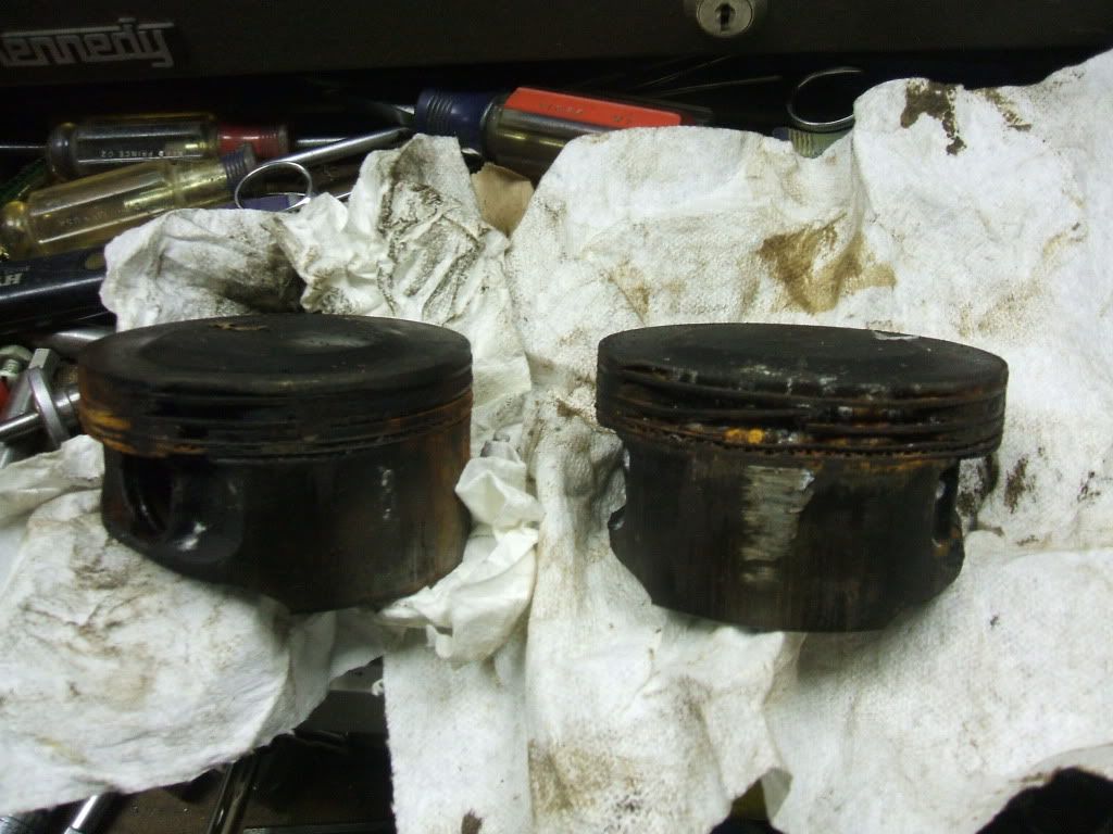

Last winter I had the pleasure of replacing a engine in a 04 GMC Envoy that a young woman drove until it quit after ignoring all the gauges and warning messages that said the engine was overheating. So the other day I started tearing the old engine down to scrap it out and I just wanted to share a couple of pictures of the burnt pistons. As you can see they got hot enough to melt the edges off.

Yep those got a bit warm. Did you have to help them out of the block with a 4x4 and large hammer?

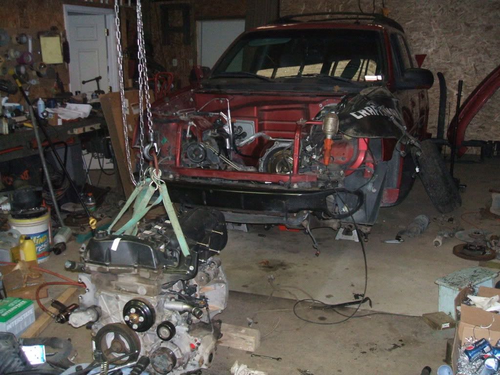

It was a 2x2 and large hammer. She called her mother when the first warning said coolant overheated and they decided that she sould try to make the rest of the way to school(20 more miles). I was out in the shop and they didn't want to bother me. She got another 5 miles before it said engine overheated and still keep driving. 3/4 of a mile further the engine siezed.
When I went to go get it with the trailer I found right a way that it had busted a heater hose. I said I had the pleasure of replacing the engine what I really wanted to say was that I'd like to wring neck of the engineer/engineers that designed a car with the front differential bolted to the side of the engine oil pan with one of the axles going thru the pan so that you have to drop the whole front suspension to remove the engine. You see the differential bolted to the side of the pan in the picture below.

Impressive, if you are going to stuff an engine, you need to do it rightSmiley
Thanks for the pictures OM, i think i have a picture somewhere of a D722 that had a nice size crater in a piston because it had a leaky injector that melted the side of the piston and caught on the bore.
