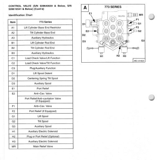

Posted: 04/22/2011 11:02 AM
The main relief valve is on the control valve. It's marked MR on the diagrams below. Its location depends on your serial number.

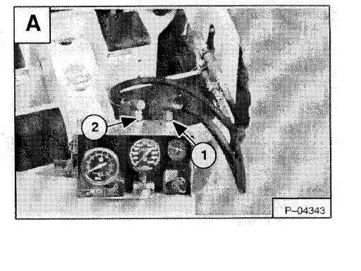

thx again for your prompt response; sorry but i worded the question wrong cause my bad EnglishSmiley how i can test the main relief valve?i don't find, not the MR valve, but how to connect a manometer for ceck the pressure i don't find a test plug Thx again

Re: bobcat 773 arm problem
Posted: 04/23/2011 08:22 AM
Hook the gauge to the female coupler for the auxillary hydraulics.

Posted: 04/26/2011 11:10 AM
ok i have test the pressure and i have measured only 1000 psi even if I have set the main relif valve. It's possible a probelm of the pump?
