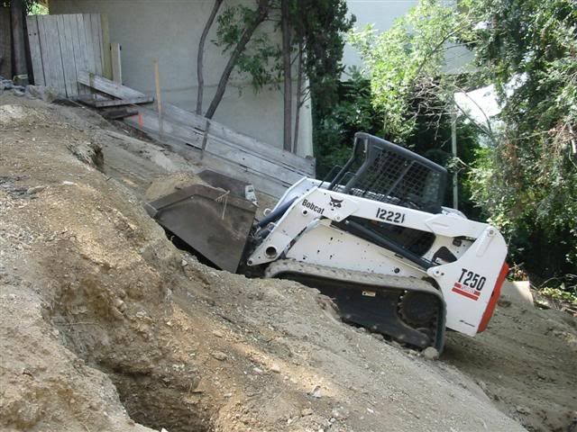

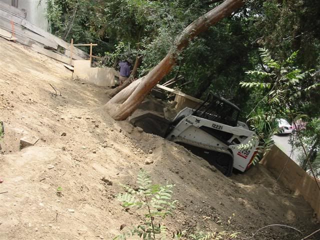

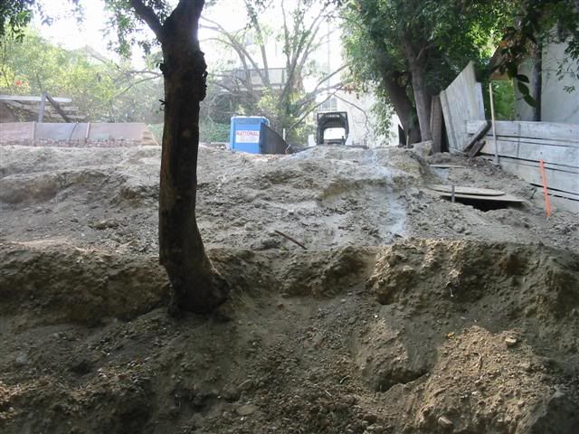

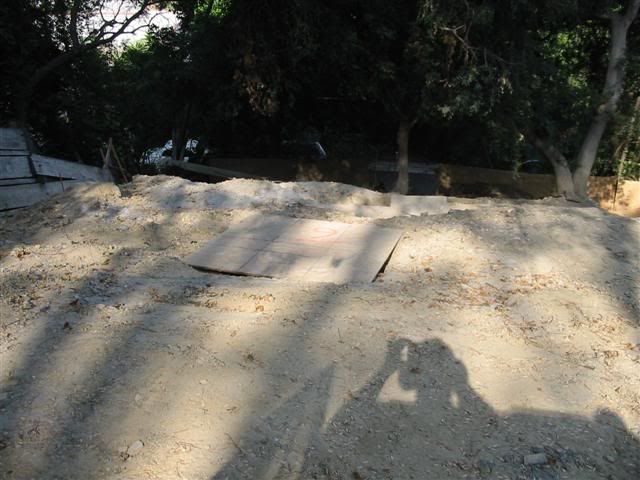

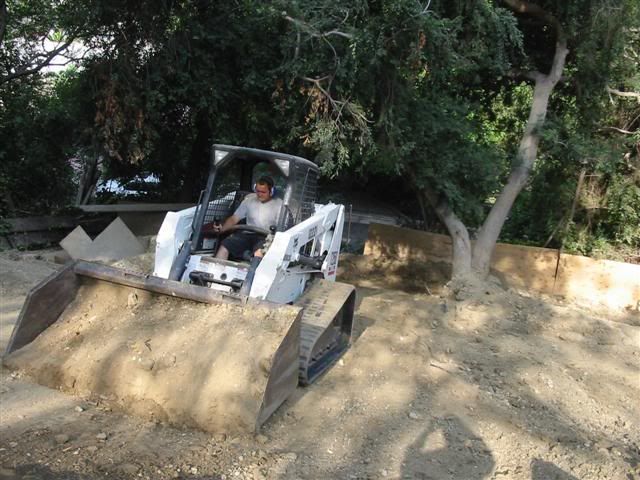

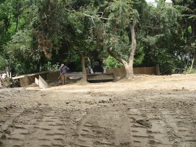

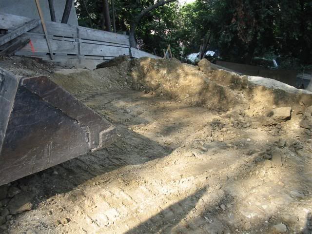

Today went pretty well. I measured the slope and it is not a 1 to 1 as I had feared. Its a little less than 1 to 1 but I forgot exactly what I had measured. I will make sure I remember tomorrow.
I cut grade going down hill first with the tooth bucket. I was only able to get half scoops.Then I backed up the hill and loaded the dirt into my 10 wheeler. I then wanted to try and grade by cutting upward. I drove down the slope backward with a bucket full of dirt just to make sure I wouldnt just flip backward if I had an empty bucket. Everything felt okay untill I began dumping out some of the dirt in the bucket. It began to feel a little light in the front and that worried me. So I decided to put my 963's smooth bucket on and use it to grade. The smooth bucket has about a 1.3 cubic yard capacity. So as I graded up hill, I would leave about 1/4 to 1/3 of the bucket full of dirt to act as a counter weight for the front end. This worked realy well. If you where to do this with the tooth bucket, the amount of counter weight dirt that I felt comfortable with would not leave you much room for spoils.
That first attempt at seeing if I could grade uphill on that slope was kinda scary. Remember, Im accessing this job from the top of the hill and theres no place to turn around at the bottom of the slope. Its not like Im at the bottom of the hill and climbing upward and then seeing what the machine can do and if it gets kinda scary then I could simply go back down.
Below are some photos from the today.
View from above.
Street down below.
View from side.
View from below.
View from other side.
If you want to see all the photos just click on a photo and it will take you to the photobucket gallery.

EER i wouldn't even attempt a job like that, that slope would scare the h*ll out of me! Just looking at the pictures i can imagine my machine rolling onto its back.
The angle looks insane, but its doing a really good job of it.
No power problems with cutting up such a steep grade? I take it your having no problems with it bogging down?
Well done!

I have found there are no problems with the engine power or proper oiling etc when on slopes that steep. However, I have found that you must have the hydraulic tank full to prevent air in the lines.

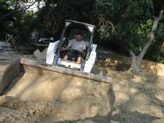

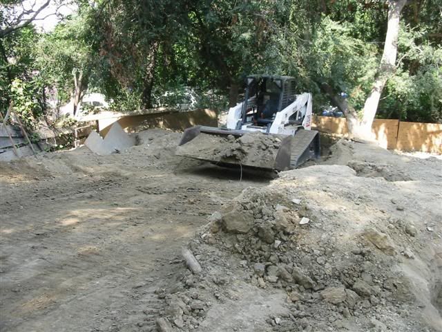

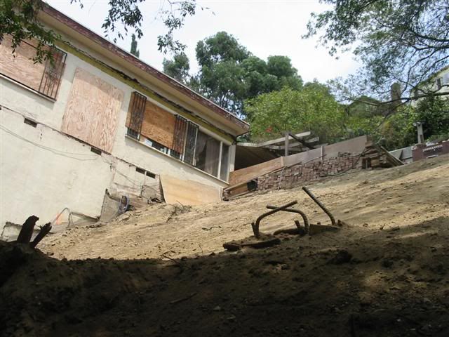

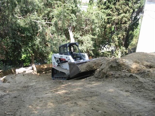

Well I measured the slope and its about 33 degrees or 12 inch run to a 8/9 inch rise. The job was a little challenging and fun. I hauled out about 50 cu. yards of dirt in two days and I was realy taking my time on this. I was not in a hurry at all. I left about 15 yards at the bottom of the hill because the contractor said that its good enough for now. He still has to redrill 3 caissons and dig grade beams to connect all the caissons. The reason he has to redrill some holes is because the 3 holes on the side are to close to the property line.
He told me that he had got dimensions for the layout from the plans. The inspector comes out and says, "wheres the survey for the property line". OOPS! No survey was done. I believe he said code requires a 6' clearance from property line. So he gets a survey done. The holes are only a 2' offset. OUCH! I then asked him why the plans where wrong. He said that the architect did not get a survey done for the plans and made one up so that he could get the ball rolling through plan check. Well he forgot to mention this to the contractor.
Who do you think is at fault here?
I think the architect is at fault here, but if I was the contractor I would of had a survey done before I began layout and drilling. Heck, he ended up having to get a survey anyway. When ever Im doing work near a property line for walls or a structure I always get a survey. Now he has to fill the abandoned holes with slurry.
Here are some photos from the second day.

You have done well, i wouldn't have the guts to even attempt that job.
I know how stable my machine is on my driveway which isn't close to that grade, its awfully light on its feet. Mind you, its not a track loader, that would help things a bit too.

Nice work. Is the T250 rented?

Yes this machine was rented. As of right now I have no need for a track loader fuul time. This is the second time I have ever used one.
