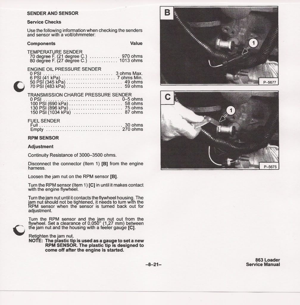

TractionLock001.jpg picture by calfranch
RPM_Sensor001.jpg picture by calfranch
Yes, the traction lock/parking brake should engage when you lift the seat bar.

The traction lock and parking brake both engage the same mechanism in the scan I posted above. The parking brake pedal just has a switch on it to engage the traction lock solenoid. Did you check to see if the parts are all there? Also did you check if it has the RPM sensor?

The solenoid is controlled by the BICS(Bobcat Interlock Control System) and receives inputs from the RPM sensor, seat bar and parking brake switch. If the traction light isn't flashing on the control box then the wiring and solenoid are likely allright.
