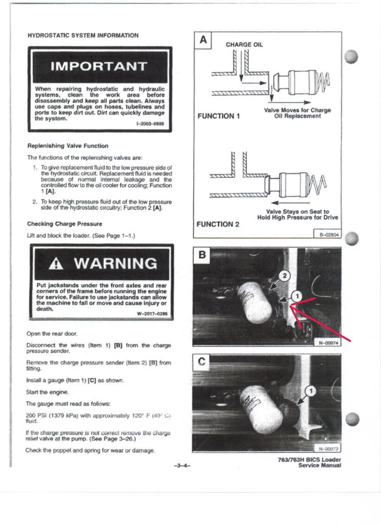

I have a error code HP -3 ("Hidraulic Oil Pressure - Wiring not conected") in my Bobcat 763, those someone have hints how to fix these thanks

HP-3 Hydrostatic charge pressure sender wiring not connected. Start at the sender next to the filter and make sure it's connected(see below). If it's connected check the resistance of the sender with the machine off and 0 PSI it should read 0-5 ohms. Next trace the wiring to check for breaks.
763ChargePressureSender.jpg picture by calfranch
